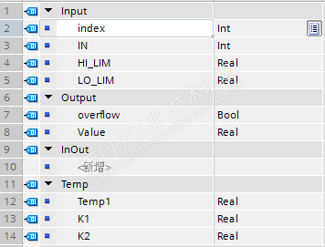

    SCALE缩放指令1200是没有的,300400才有。如果现场传感器是4-20ma,模拟模板是0-20ma,那么SCALE指令里K1和K2就应该是5530.0和27648.0。但因为SCALE指令里K1和K2固定为两种情况,BIPOLAR为0,K1=0.0,K2=27648.0这是单极性;BIPOLAR为1,K1=-27648.0,K2=27648.0这是双极性。因为K1\K2不在接口参数里,所以K1=5530和K2=27648.0无法实现,你最好自己写一个块更灵活点。
    CASE #index OF
        1:
            #K1 := 0;
            #K2 := 27648;
        2:
            #K1 := -27648;
            #K2 := 27648;
        3:
            #K1 := 5530;
            #K2 := 27648;
        ELSE
    END_CASE;
    IF #IN < #K1
    THEN
        #Temp1 := #K1;
        #overflow := 1;
    ELSIF #IN > #K2
    THEN
        #Temp1 := #K2;
        #overflow := 1;
    ELSE
        #Temp1 := #IN;
        #overflow := 0;
    END_IF;
    #Value := (#HI_LIM - #LO_LIM) * ((#Temp1 - #K1) / (#K2 - #K1)) + #LO_LIM;
